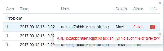

    No such file or directory error for Script Media Type
    I was using the Slack Integration for Sending notifications from here
    Zabbix AlertScript for Slack.com chat. Contribute to ericoc/zabbix-slack-alertscript development by creating an account on GitHub.
    Setup was done fine, but I am facing one issue, whenever I run the script from command line, the Message is pushed to Slack successfully but when the script is invoked by Action to send Notification, I get error as
    /usr/lib/zabbix/alertscripts/slack.sh: [2] No such file or directory
    (The script file is at this location only)
    I have tried changing the owner of script to zabbix, and group also as zabbix, still it didn't work.
    I am using Zabbix 3.2.7 which has alertscripts location as /usr/lib/zabbix/alertscripts/

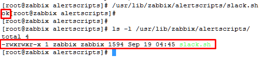

      Hi
      Sorry for the typo in post (I rectified it now).
      The script is slack.sh only and even when i execute the same path which is given by error, the script runs successfully and pushed message to Slack, but this script is unable to be called by Zabbix.
      [root@zabbix alertscripts]# /usr/lib/zabbix/alertscripts/slack.sh
      ok[root@zabbix alertscripts]#
      [root@zabbix alertscripts]# ls -l /usr/lib/zabbix/alertscripts/
      total 4
      -rwxrwxr-x 1 zabbix zabbix 1594 Sep 19 04:45 slack.sh
      Please find below screenshot.

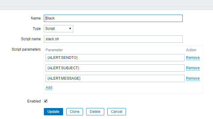

        • yatin
          • Sep 2017
          Yes,
          Media is all correct.
