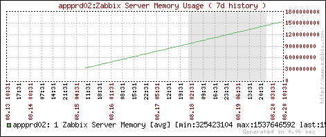

How to tell if Zabbix has memory leak?
  • drose12
    • Apr 2007
    • 27
    #16
    Originally posted by drose12
    I've created mine as well...I'll post my results after a day or so as I've just restarted zabbix to show the trend.
    Ok, here are my results, and they don't look promising...as you can see the memory consumption of my zabbix server daemons is pretty constant and doomed to consume all my memory.

      I've created a crontab job to restart it ounce a day for now. Not the right way but a quick fix for now until I can find out what is going on.
      • drose12
        • Apr 2007
        • 27
        #18
        Yea, not what I want to do...I'm hoping to convince the powers to be (developers?) that there is a problem.

              I am just curious if it is something in my setup but I am having to restart zabbix_server every 6 hours due to a major memory leak. After 6 hours the process according to "top" is using 32M per process. Is anyone else seeing this? I've created a crontab to restart the service every 6 hours until I can figure out what's going on with my system. It might be my setup not sure yet. I am currently running Pre 1.4.3.

                Is anyone else seeing memory leaks with Pre 1.4.3 or is just me?

                    #24
                    Thanks Alexei for the quick reply.
                    I'm running the newest code, Pre 1.4.3, in the developers link. It seems to increase faster the more Web checks I add. I will do some experimentation by turning off Zabbix_Senders and watch it for a while and will do the same test with the web checks to see if my memory for the zabbix_server process grows. Thanks for help and keep up the good work, Zabbix is a great tool. :-)

                          #27
                          Thanks for that info. It appears to be in the SNMP pollers.

                            #28
                            Here another snapshot of the memory 30 minutes later. You can see the SNMP pollers grew by at least 1000K withing just 30 minutes.
                            It's the Resident Memory Size that is increasing.

                              #29
                              30 minutes more the snmp pollers have increased the RES memory from 10m to 14m.

                              • Palmertree
                                • Sep 2005
                                • 746
                                #30
                                Solution Found
                                I have found why my SNMP pollers were leaking memory. I wanted to share this with everyone because this might be a problem for a lot of people and it took me a few days to figure this out. The problem is not in the Zabbix code but the NET-SNMP libraries. There is a major memory leak in the libraries for "NET-SNMP Version 5.4". I was able to determine this by running "Valgrind" and saw the "varbinds" leaking like crazy. NET_SNMP version 5.4 is used in most yum installs. Net-SNMP Version 5.4.1 fixes these memory leaks. I had to down load the newest version and compile it. After installing version 5.4.1 of NET-SNMP you must recompile Zabbix Pre 1.4.3 (do not use 1.4.2, has a memory leak in the trappers).
                                NET-SNMP Release Notes
                                Release Name: 5.4.1
                                Notes:
                                *5.4.1*
                                snmplib:
                                - [BUG 1619827]: link libraries against needed external libraries
                                - [PATCH 1616912]: fix memory leak in UDP transport code
                                - [PATCH 1592706]: fix memory leak when cloning varbinds
