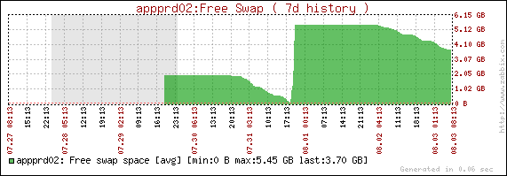

    How to tell if Zabbix has memory leak?
    1.4.2 from SVN.
    CentOS 4.5, 2.6.9-55ELsmp
    3GB RAM, 6GB swap
    Been running only for a day or so, but I see that the zabbix_server processes are starting to take up quite a bit of memory...280MB VSZ and 118MB RSS, but only for 10 of these:

    My swap use is trending up...
    see attachment...

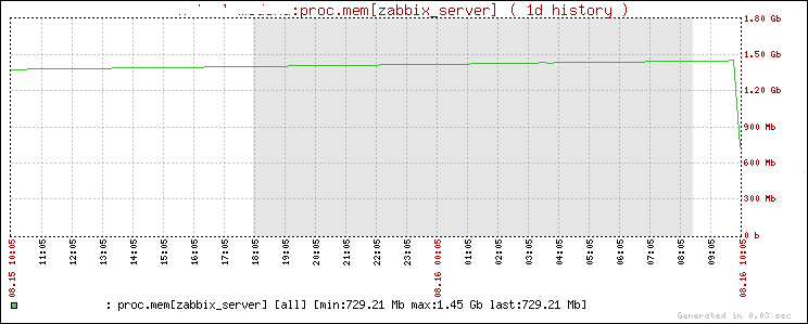

                              #15
                              So this is getting to be a problem. I though our server was going to crash and burn today. Luckily it came back after about 5 mins. When it was finally responding, i typed "uptime"
                              load average: 44.41, 29.11, 14.10
                              So it appears a simple stop of zabbix caused the load to go from a normal 1-2 to 44
                              Attaching my proc.mem[zabbix_server]
                              Help!
