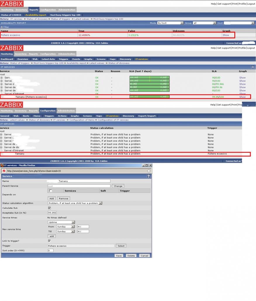

May be some screens with your configuration of IT service?

"100% sla" seems to be reproducible in trunk. is there a report on the tracker ?Comment
Found the "problem"...
Looked in the database and it seems to me that service alarms are only gathered after you create a service to monitor and that's why it's always 100% (at least from the beginning).
Well, it probably works as it should.
Do I like how it works? no,
There's obviously a lot of different solutions to the "problem", but I would believe that someone is already in to fixing this in another way?
/GustavComment
i think people in this thread are referring to the fact that sla stays at 100% even when linked trigger event history clearly shows that not being the case - and for problems happening after the it service was created. at least i can reproduce such a problem in my trunk installation.Comment
Are you sure it works like that?
I have the same setup I believe, that is link to trigger checked...
When I tested it out I can see that it works, but only from the time I created the service.
When I check the database, there's a table called service_alarms and the rows within it is exactly what builds the SLA showing in the IT-service.
Can someone who wrote the code tell me if I understood it correctly?
Personally I think it would be better if it would actually have been linked to a the trigger for a particular host, so that one could generate SLAs retroactively.Comment
we probably misunderstood each other. the idea is, it service should have the same events as the trigger it is linked against for the period it is linked.Are you sure it works like that?
yes, generating sla would be very nice - maybe you can search the feature request tracker & enter a new request if one doesn't exist alreadyComment
