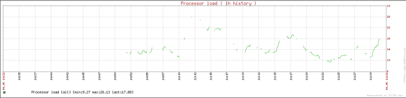

        Still have this performance problem.
        Load average without zabbix : around 2.
        With Zabbix monitoring itself with some checks provided by the agent : see the graph... quite unbelievable (and have a look at the right hand bottom at the time made for the creation of this graph...).
        See attached image or here :
        http://tof.canardplus.com/show/98326...74c02da14.html
        Is it due to some Oracle performance parameter ?
        Is it due to VmWare environnement ?
        Do I need to change something in RH ?
