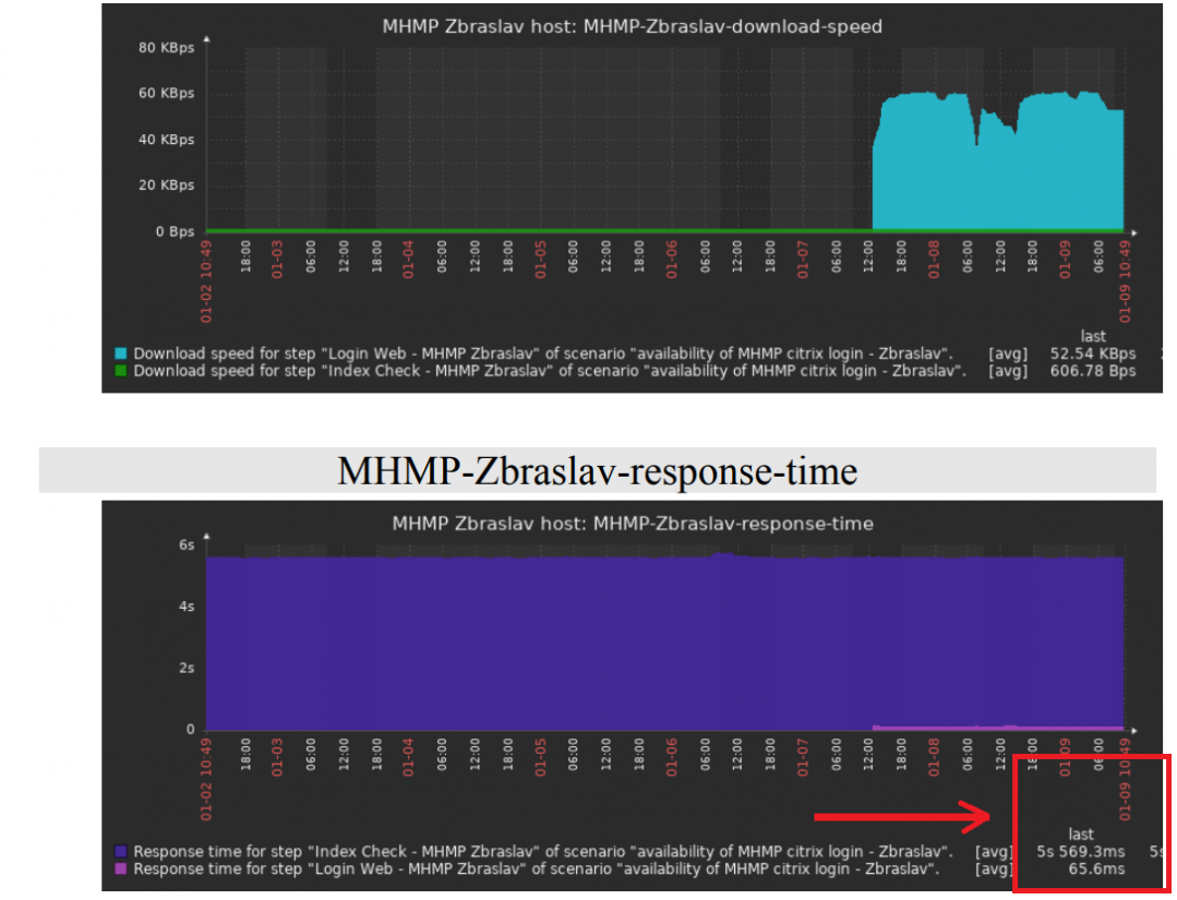

          Hi all,
          I have zabbix 4.0 installed and zabbix_pdf_report working. But when I generate PDF there is not complete legend in graph. X a Y axis is OK and complete, but legend not even if I switch to another paper layout.
          thank you for tips
          Jan

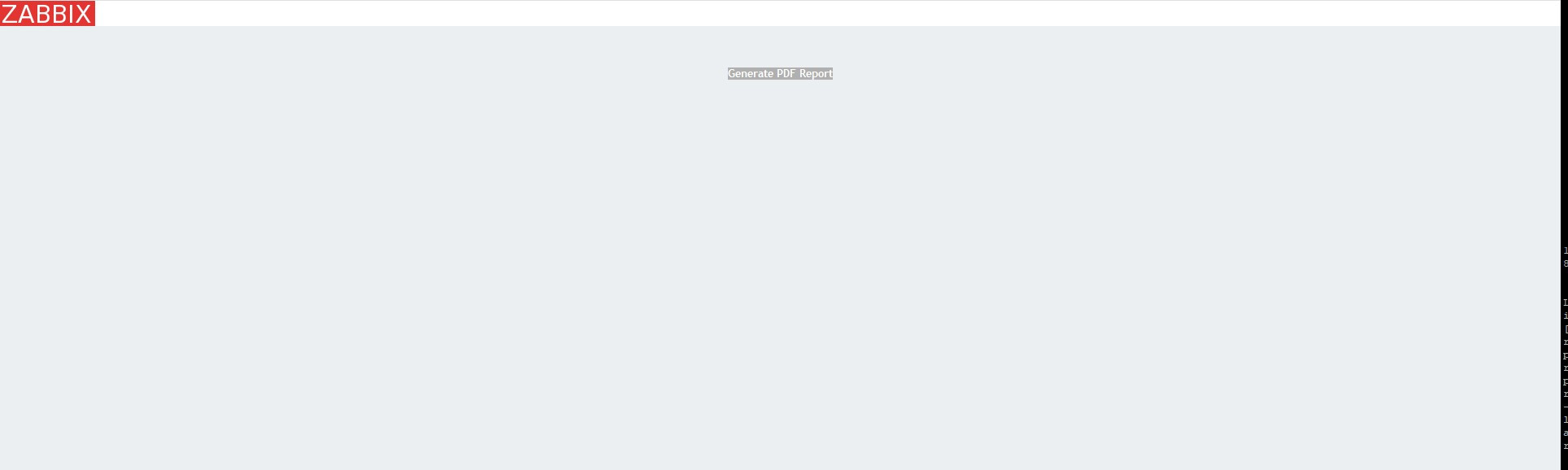

          I have zabbix 4.4 installed on ubuntu 18.04 and i have some issue with page where i should generate PDF. I see only "Generate PDF Report" and it's all. Can I please for help?
          • cottirola
            • Jan 2020
            #399
            Please Help, I can log in the site but gives me a white screen, please help

              #400
              Hi All,
              I see only "Generate PDF Report" and it's all. Can you please help me to address this issue?
