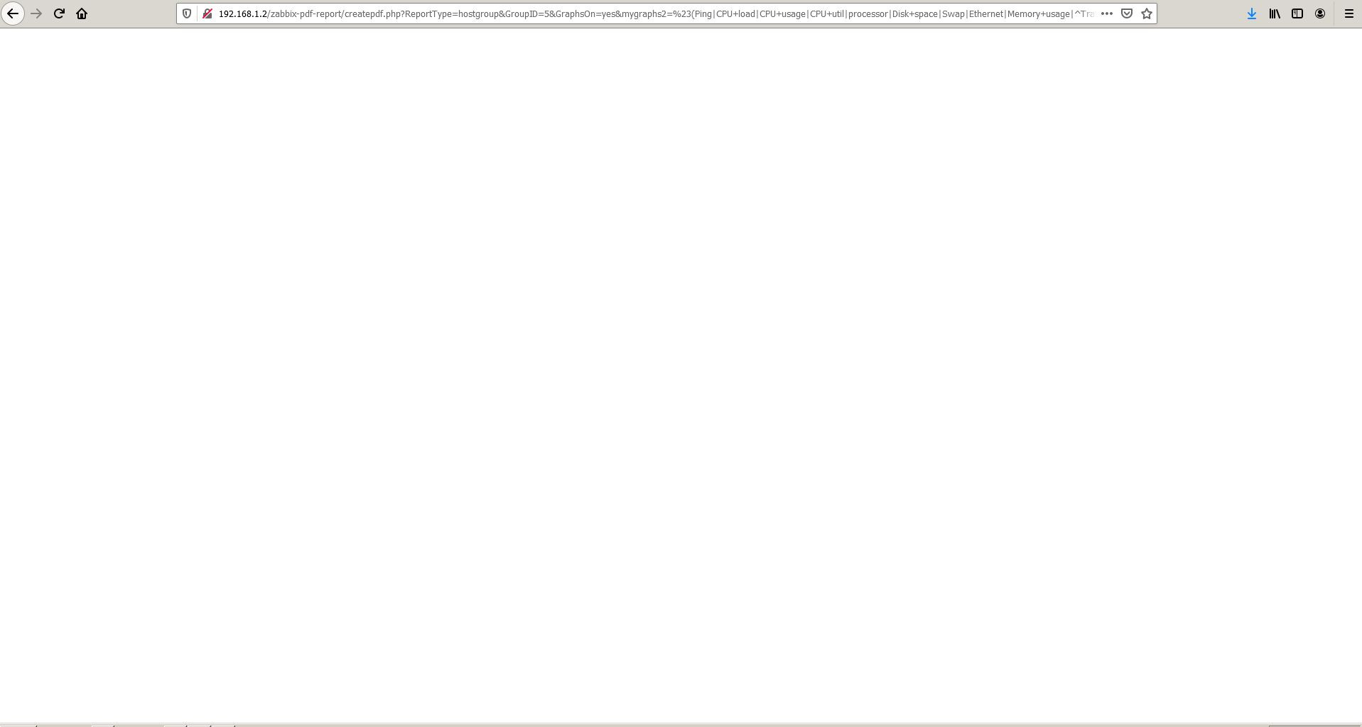

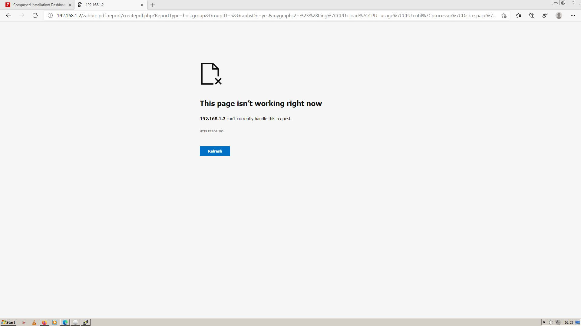

    • rizkysyahrian
      • Jan 2021
      #440
      when trying with other browser
      • martinm_76
        martinm_76 commented
        Okay, clearly there's a configuration problem somewhere. 500 is Internal Server Error and probably either a spelling mistake/syntax error or missing component. Look in the error log.

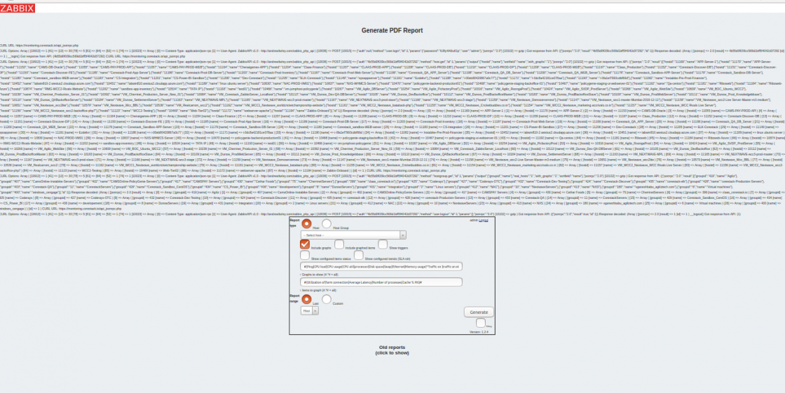

      Hi Team,
      I am also facing the same issue like https://www.zabbix.com/forum/zabbix-...237#post416237
      after selecting host i am facing this curl page.
      I am using new code only from https://github.com/martinm76/zabbix-pdf-report.
      martinm_76 please help me on this
      • martinm_76
        Update config.inc.php and set version to 5.0. I think something changed even in the 4.4 series some time before 4.4.10, so even if still om 4.x, try saying 5.0
