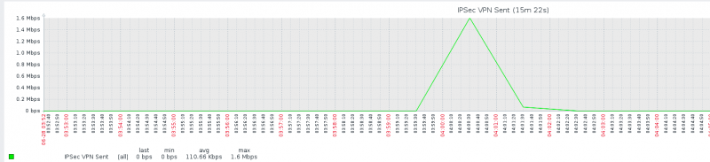

    Hi all,
    I've got a Cisco ASA and my Zabbix server is monitoring a VPN traffic on it. This is another device than [1].
    I've created a trigger that will trigger if there is no traffic on that VPN between 4AM and 5AM.
    However, the alert is triggered even when there is traffic. I would like to know what I am doing wrong, please.
    Trigger expression:
    {Cisco_ASA_2:query_lan2_lan_cisco_final.pl["public","192.168.9.254","ASA","get","TX","201.201.201.201"].max(1h)}=0 and
    {Cisco_ASA_2:query_lan2_lan_cisco_final.pl["public","192.168.9.254","ASA","get","TX","201.201.201.201"].time(0)}>040000 and
    {Cisco_ASA_2:query_lan2_lan_cisco_final.pl["public","192.168.9.254","ASA","get","TX","201.201.201.201"].time(0)}<050000
    Latest data:
Name:	Screenshot from 2018-06-29 09-31-15.png
    What am I missing?
    Thanks in advance.

      When did the alert trigger, precisely?
      If I looked at the chart, between 4:00:00 and 4:00:29 or so I think the query is valid. You are checking if the current time is between 4 and 5, but if the prior hour's data (as of that time) is max zero. If there was a data item polled then, I think it would be true?
      If you are trying to check if all values between 4am and 5am are zero you need something different (I'm not quite sure what, frankly, but different -- maybe that check fires only at 5am (though you have to be sure there is a poll at that time if you try isolating it to a specific time to check; the evaluation is made at polling not at a specific time of day).
        I just want a trigger that:
        If there hasn't been any traffic between 4am and 5am, then trigger an alert. Else all good.
        The alert triggered at 04:30am and it got recovered 1 second later (04:31am).

          I can't explain it then. But I think the trigger itself is written incorrectly, remember it is going to be evaluated at each poll, so (for example) when it is evaluated at 4:15, it will look back to see if there are max zero from 3:15 to 4:15, because the current time is between 4 and 5. It's not a query, i.e. the 4-5 portion is not a where clause for selection.
          What makes your request difficult is the need to look at a particular hour; most zabbix usage for triggers looks at relative time -- the prior X minutes. So it's relatively easy to tell if the prior hour had max zero.
          Related question: A trigger generally is supposed to have something that clears it, so that the alert condition goes away. What clears your trigger?
          To do what I think you need some kind of a kludge. Say you poll ever 2 minutes.
          If the trigger is not now set, and the time is between 5:00 and 5:03, max(60m) = zero OR
          if the trigger is now set, and the time is between 5 and 6.
          So if there is no current alert it will check once at a poll near 5am (+/- 1 minute to make sure you catch a poll every 2), and evaluate your condition and trigger (or not). If it triggers, it just keeps triggering until 6am then resets.
          But... I'm not sure that is really what you want?

            The problem here is that.. I already have a trigger like that working for another device. And it works pretty good!
            I think the issue here is that for this particularly case, the traffic happens before 4am(3:59am):
Name:	Screenshot from 2018-07-03 13-39-01.png
            It just doesn't make any sense to me... why for the other device it works? it has to be something wrong I am doing....
