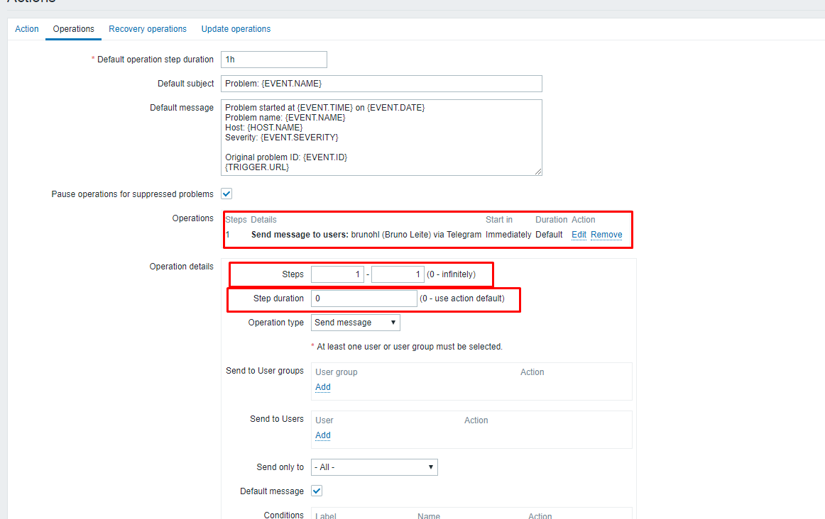

      The image beneath shows the action screen:

          Look at the board beneath:
          In this case I have 3 operations, but 2 steps. What will happen if the trigger fires:
          - It will send an e-mail to "sarandi.eletrica" and send a message to bot "sarandi.eletrica" and "sarandi.forahorario" via "Sarandi - Audio Compressor" simultaneously (look at the start in).
          If the problem persists, in 3 minutes (look at the third event "start in") it will send a message to "sarandi.ivar" via "Sarandi - Audio Compressor".

              You have to specify the time in seconds for the first step (step duration), it will automatically set the time for the second step to start.
