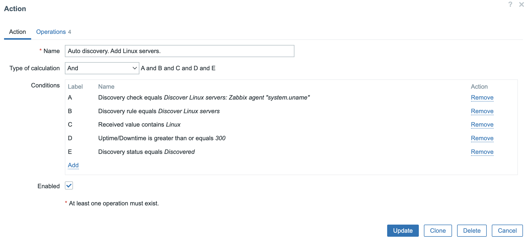

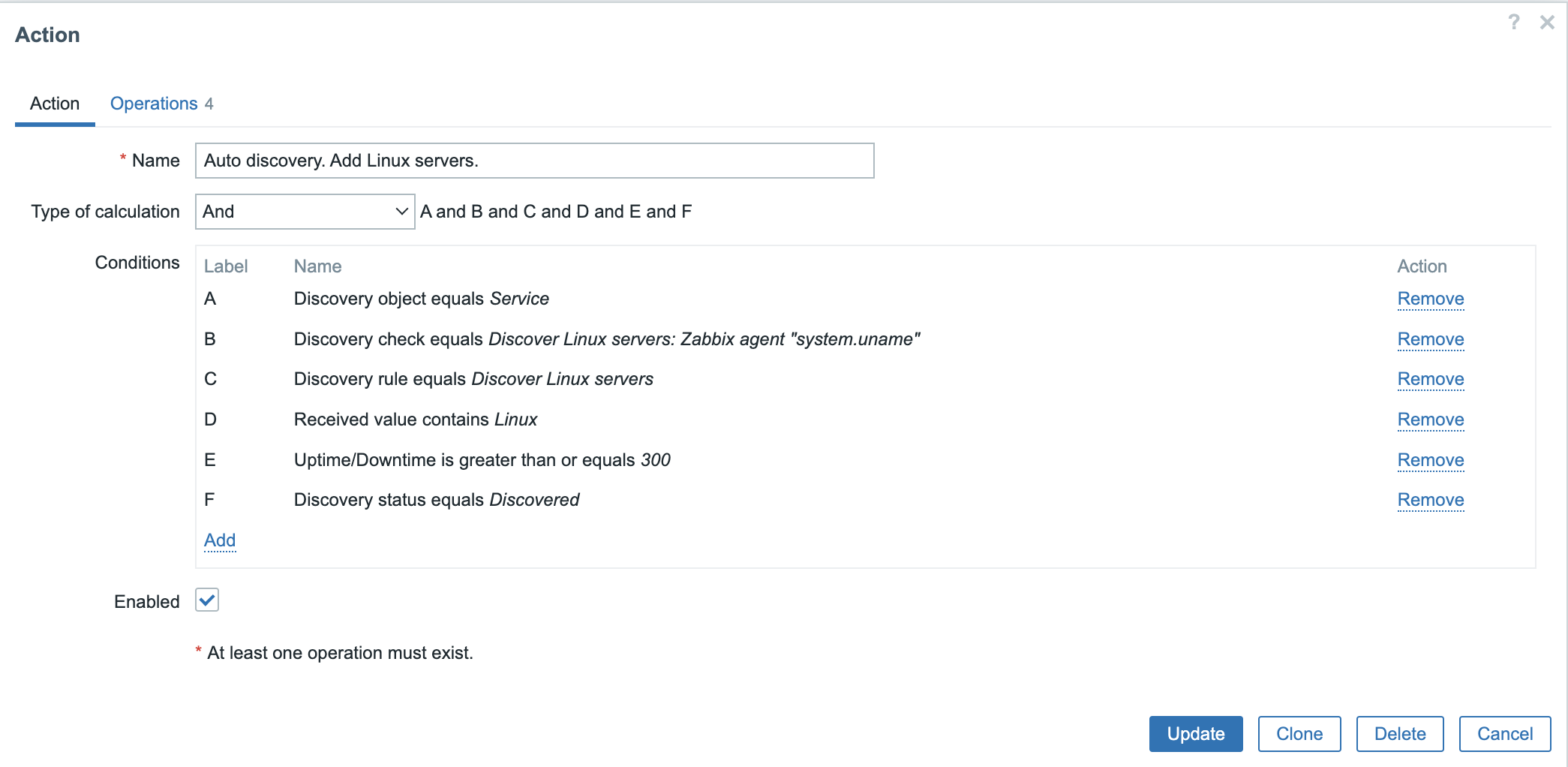

          I have the same issue (on Zabbix 6.4) but not with email, I use discord for sending a message if a host is added. I tried to use the option "Discovery equals status Discovered". As I can read in the documentation, this should only report a device when it's new and a service is "Up".
          This is te line from the documentation which I found on https://www.zabbix.com/documentation...ery#discovery:
          Host Discovered At least one service of a host is 'up' after all services of that host were 'down' or a service is discovered which belongs to a not registered host.
          But when I use "Discovered", a host won't be added. If I use "Up" it works but runs (and sends messages) everytime the discovery is run. Do I use "Discovered" wrong or am I forgetting something?
