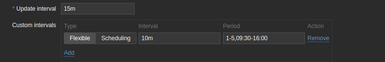

    Running zabbix 4.4, and I cannot get the flexible interval to work!
    If i set the interval to 0, it will not even run at all, and if its set like below, if will run every 15 minutes which it should not. I would asume it should run every 10 minutes instead mon-fri form 09:30 - 16:00. But it runs 24/7 every 15 minutes.
    What am I missing here?

    Pls read https://www.zabbix.com/documentation...stom_intervals Pay attension to the chapter "Custom intervals correlation"

      According to the table, it should poll every 10 minutes and NOT every 15 minutes ?. And it should still work, if I set the value to 0, where the item just go into an error/disable state if I do so.
      Also the log shows this: " 1024:20201009:111216.240 active check "test" is not supported: Incorrect update interval."

        Just use 600 as interval.
        • lbm
          • Feb 2020
          • 37
          Same issue, item because unsupported with these settings...
          Update interval:0
          Flexible-Interval 600.
          And with below, it polls every 15 seconds, and not 600 as expected.
          Update interval:15

                  Im running version 5.0.10. Its always "Incorrect update interval." if update interval is set to zero.
                  The section Custom intervals correlation in this doc doesn't work at all:
                  • carstenj
                    • Jul 2020
                    • 9
                    Ok, I found out why it isn't working for me: I use an active agent, and obviously custom intervals aren't working there.
                      Aaah.... Thats why. Same here. Come from another installation where we used "passive" agents.
                      Its also stated here, actually: https://www.zabbix.com/documentation...fig/items/item under "Custom intervals".
                      Thanks.

                          answer to 7. found on the page, where item creation is described... https://www.zabbix.com/documentation...fig/items/item From there link takes you to description of custom intervals... So not always you can read pages in random order unfortunately..
                          Custom intervals You can create custom rules for checking the item:
                          Flexible - create an exception to the Update interval (interval with different frequency)
                          Scheduling - create a custom polling schedule.
                          For detailed information see Custom intervals.
                          Time suffixes are supported in the Interval field, e.g., 30s, 1m, 2h, 1d.
                          User macros are supported.
                          A single macro has to fill the whole field. Multiple macros in a field or macros mixed with text are not supported.
                          Scheduling is supported since Zabbix 3.0.0.
                          Note: custom intervals for active checks are supported by Zabbix agent 2 only.
                          In docs for v5 that line is "Note: Not available for Zabbix agent active items." So only for passive items... yea.. a bit of confusion may appear about passive checks in later docs.... Some reading between the lines needed..
                          So your possible solution for active items and custom intervals is to use agent2. ​
