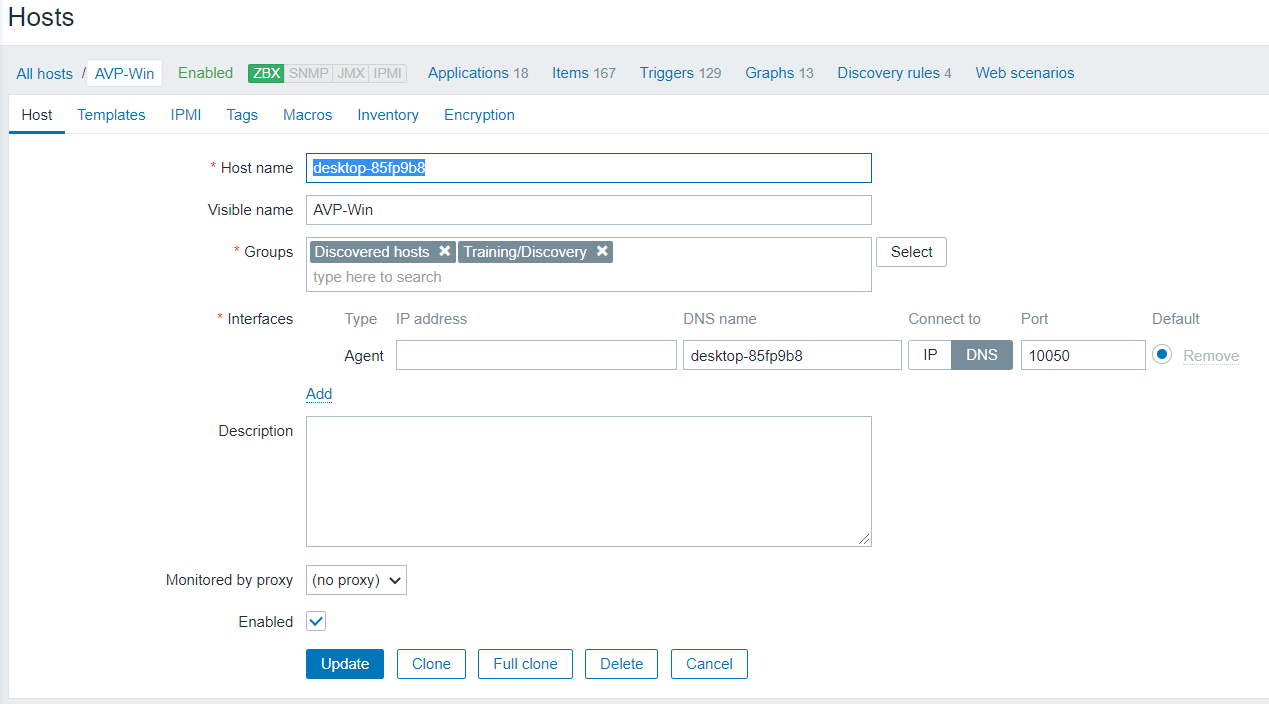

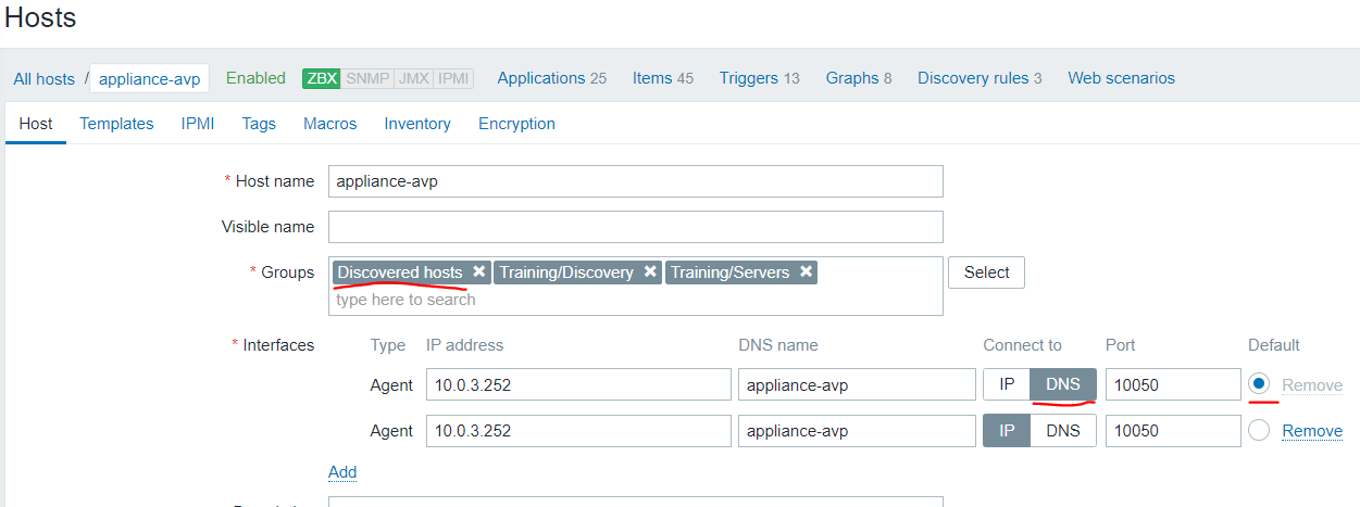

        It's working fine for me, please see examples:
