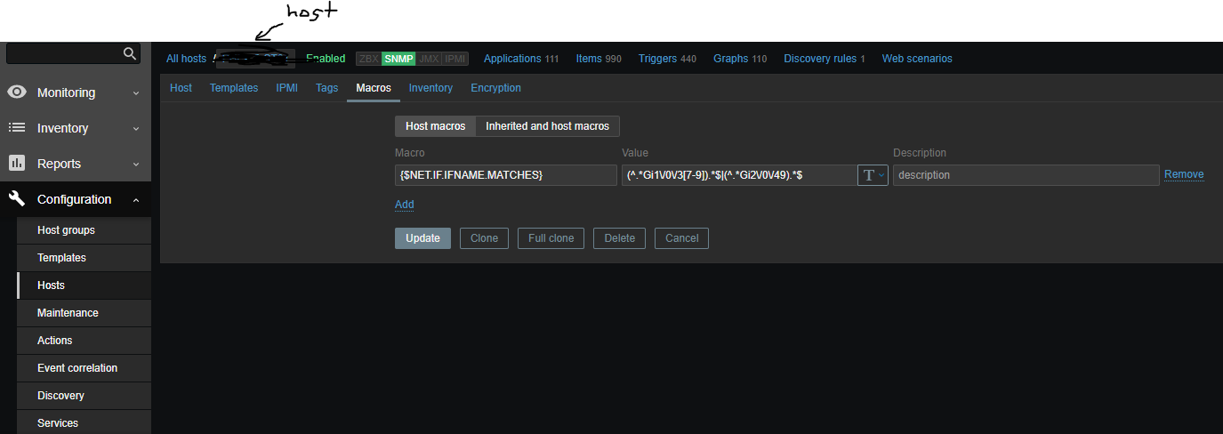

    I have tried multiple ways to filter on the network port name in the Template Net Cisco IOS SNMPv2 | Template Module Interfaces SNMPv2, and it just doesn’t seem to work. I have reviewed the forums, and this idea of filtering on ports comes up a lot, but the only answer that is confirmed to work is to manually disable each of the unwanted alerts. I don’t like it as an answer, but I also don’t want to keep chasing red herrings.
    I have tried filtering using the MACRO on the Template Module Interfaces SNMPv2, and I’ve also tried it using “Filter” on the Discovery Rule in the Template Module Interfaces SNMPv2. I’ve tried variants on the regexp, all of which I’ve confirmed match the name of the port Gi1/0/42 and/or iso.3.6.1.2.1.31.1.1.1.1.10142 and/or GigabitEthernet 1/0/42 (just in case that’s the name of what is coming through)

        And what I discovered, is that I was working in Templates, when I am having more success applying a MACRO to the individual host. This may suit me better as each of our switches have different ports requiring monitoring.
        And then once it's setup, go to Monitoring, Latest Data and the host to see what is being pulled. If the wrong information is there, then go to Configuration, Host, Discovery Rule and then check all Discovery Rules and "Execute Now" (or it's sometimes "Check Now")
        Click image for larger version  Name:	host.PNG Views:	0 Size:	40.6 KB ID:	413833
        And the Discovery/Filtering can take a while. That's the main thing that was missing from all the other posts. I'll update when I have a better idea of how long to wait.
