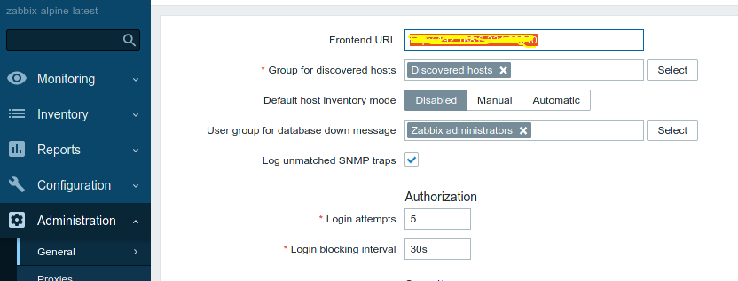

      Need to add url of your frontend in zabbix GUI.
      I guess it's section administration > general. Or somewhere there

        • gofree
          • Dec 2017
          • 400
          my memory failed me - its administration - general - other

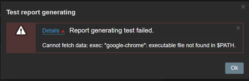

                • dilan bandara
                  • Mar 2021
                  • 7
                  Hi Guys,
                  Same things we have tried out in our zabbix environment. But once all configuration completed, It giving below error, Anyone familiar for below error, Please guide us.
                  Cannot fetch data: exec: "google-chrome": executable file not found in $PATH.

                  • gofree
                    gofree commented
                    check second post in this thread
