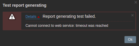

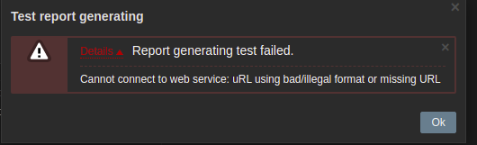

        #19
        Hi, anyone can help me please?
        -I've install zabbix-web-service and i start it
        -i've add in zabbix_server.conf "StartReportWriters=1"
        but now how i can know the url that i must add in administration -> general ->other?
        My site is: https://exdample.com/zabbix and i've tried http://localhost:10053/reports but the test fail...
        in zabbix_server.conf: i've add WebServiceURL=http://localhost:10053/reports but is wrong i think
        thank you
        *Update*
        I've add in zabbix_server.conf:
        WebServiceURL=http://localhost:10055/reports
        In zabbix_web_server.conf:
        ListenPort=10055
        but now i see only :
        curl http://localhost:10055/reports
        404 page not found
        *Update2*
        report....not reports....sorry, i've add the correct url in zabbix_server.conf
        Details Report generating test failed.
        • Cannot fetch data: chrome failed to start:
        • /usr/bin/google-chrome-stable: error while loading shared libraries: libatk-1.0.so.0: cannot open shared object file: No such file or directory
        i've installed libatk-2.0.so
        But now i see a timeout, logs don't help...i'll see now
Name:	Schermata da 2021-06-07 11-14-03.png
