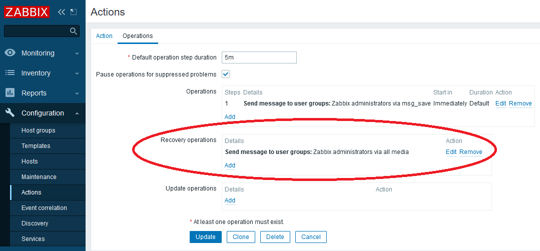

    Hey there!
    please try to leave "recovery options" of your action empty

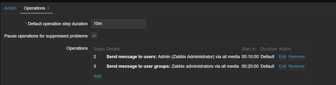

      Explaining a bit about how to delay a notification (in your case, send it only in the first 10 minutes of the problem)
      In the example above, I specify that each step will take 10 minutes in "Default operation step duration"
      Saying that starts at step 2, means that the first action in my list will only start after 10 minutes. (as step 1 will be equal to nothing and will only go to the next step after 10 minutes)
      So zabbix will only send any alert after 10 minutes, if the alert is still there.
