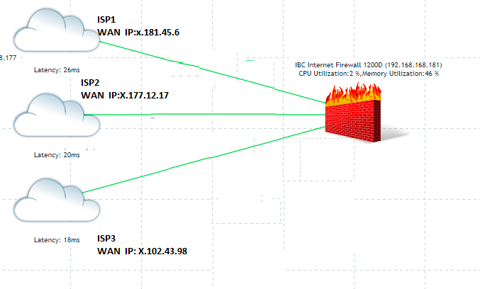

    We're planning to migrate into zabbix for firewall monitoring and we're running a POC. We ran into what seems to be a common problem and need your help.

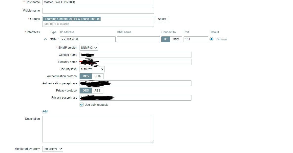

    We've multiple firewall deployed all across the country. All firewalls have 3 lease lines connected and all 3 are in load balancing mode. Firewall is configured to send out SNMP V3 data from all 3 lease lines. However in zabbix we've configured only primary WAN IP(lets say: XX.181.45.6) for SNMP V3 data. To monitor other 2 lease lines, We've created 2 separate hosts with only ping template.
    Now the problem is... When ever XX.181.45.6 goes down we receive firewall unreachable alert even when other 2 links are up. We created custom trigger with dependency between other 2 hosts, This resolved the firewall unreachable alerts but we still don't receive SNMP data while the primary link is down.
    Our network architecture seems to be common one and we need to know if there's any way to receive SNMP alerts from the host even if the 2 links are down.
    Bellow is our network architecture and host configuration.
    Need your help in resolving this.... Thanks in advance.

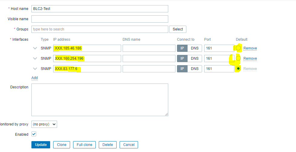

        Created 3 interfaces and made 1 default as bellow. Now I'm not able to delete this interface any way to change this automatically when the IP is not reachable?

        • ISiroshtan
          • Nov 2019
          • 324
          Would you instead of deleting interface try to promote different one to be a default one?
          The HostInterface Object has 'main' property in it. I would expect you to be able to use HostInterface Update method to change said property on one of the other two interfaces to make it default.
          Hope it helps.
          • superlava
            superlava commented
            Thank You. This should work... and yes, I can make other interface as default one. But I was looking for a built in feature to switch between interfaces based on Host reachability status.
        • ISiroshtan
          • Nov 2019
          • 324
          Hey superlava.
          I understand what you want to do, but I don't see/know any easy way to achieve it.
          I can expand a bit on proposal from tikammi, like instead of using shell script that will continuously ping your routers/read data of specific trigger, you can create a new action in Zabbix, that will react to "Host unreachable" trigger of specific host group and as a reaction would call a script passing {HOST.ID} macro as an argument. Said script, in turn, would auth in Zabbix API, get interface list of host by provided hostID, will start to ping router interfaces one-by-one and as soon as any of them responds - set that interface as default.
          This way, if you have multiple hosts with such setup, you don't need to have a separate shell script for each host. Rather you just need to make sure it's in needed host group for said action to be triggered.
          I can see this working in theory, but obviously i never did make such a set up before so not sure if there are any downsides or issue you might encounter trying to implement it.
