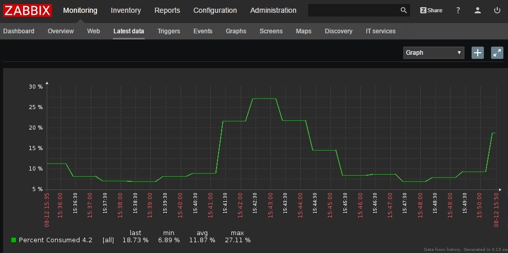

              I believe that will suffice for what I need. It Definitely does help and I am very appreciative.. Could You post a screen shot of the calculated item you created for that?

                        Thanks again kernbug and its works!!! This is the correct key value:
                        • 100*last(net.if.in[ifHCInOctets.10121])/1073741824 ​​​​​​
                        NOTE: Where 1 gigabytes = 1073741824 bytes (I use this Bit Calculator)
