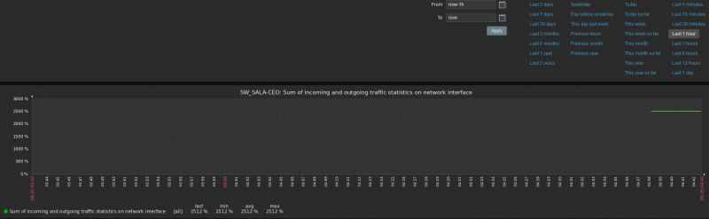

    Hi Kernbug
    I was reading about Items in the Zabbix Documentation and i was could discover this, look at the attached pictures...
    I need to change the 2512% to another value (in percent) like 25%, 2.5%, etc.

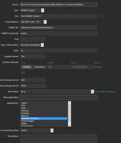

      Another information Kernbug
      In: Configuration > Host > Items > Create Item > Key (Select), i get this:
      net.if.in[if,<mode>] Incoming traffic statistics on network interface. Returns integer
      net.if.list Network interface list (includes interface type, status, IPv4 address, description). Returns text
      net.if.out[if,<mode>] Outgoing traffic statistics on network interface. Returns integer
      net.if.total[if,<mode>] Sum of incoming and outgoing traffic statistics on network interface. Returns integer
      I don't know whats means <mode>
      Sorry for the inconvenience...

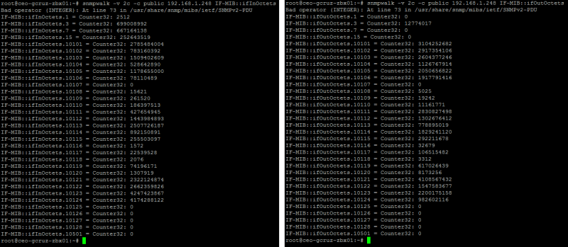

                    #24
                    Linwood
                    I did what you recommended me. Look.
                    These are the results of both queries in SNMPWALK

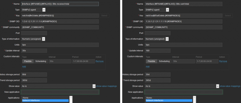

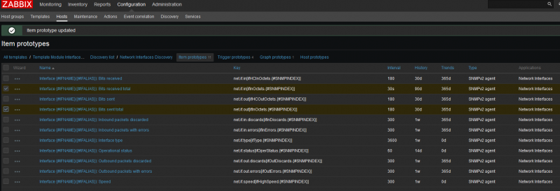

                    Then, in Template Module Interfaces SNMPv2 > Discovery Rules > Item Prototypes I made these two ítems
Name:	two item prototypes.PNG
                    An image of each one
Name:	item prototypes ifInOctets + ifOutOctets.PNG

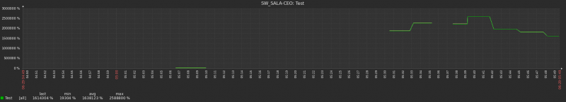

                            This shows the graph with the sum totals of interfaces 21, 22 and 23.
Name:	test result.PNG
                            I do not like that you show 1816528%, how can I correct that?

                              • grmnrvs
                                • Jun 2018
                                • 35
                                #30
                                Originally posted by kernbug
                                Please, adapt math according to your task.
                                I did it but it still does not work
                                This is my Calculated Item Formula
                                100*last(net.if.in[ifHCInOctets.10101])+last(net.if.out[ifHCOutOctets.10101])+last(net.if.in[ifHCInOctets.10102])+last(net.if.out[ifHCOutOctets.10102])+last(net.if.in[ifHCInOctets.10103])+last(net.if.out[ifHCOutOctets.10103])+last(net.if.in[ifHCInOctets.10104])+last(net.if.out[ifHCOutOctets.10104])+last(net.if.in[ifHCInOctets.10105])+last(net.if.out[ifHCOutOctets.10105])+last(net.if.in[ifHCInOctets.10106])+last(net.if.out[ifHCOutOctets.10106])+last(net.if.in[ifHCInOctets.10107])+last(net.if.out[ifHCOutOctets.10107])+last(net.if.in[ifHCInOctets.10108])+last(net.if.out[ifHCOutOctets.10108])+last(net.if.in[ifHCInOctets.10109])+last(net.if.out[ifHCOutOctets.10109])+last(net.if.in[ifHCInOctets.10110])+last(net.if.out[ifHCOutOctets.10110])+last(net.if.in[ifHCInOctets.10111])+last(net.if.out[ifHCOutOctets.10111])+last(net.if.in[ifHCInOctets.10112])+last(net.if.out[ifHCOutOctets.10112])+last(net.if.in[ifHCInOctets.10113])+last(net.if.out[ifHCOutOctets.10113])+last(net.if.in[ifHCInOctets.10114])+last(net.if.out[ifHCOutOctets.10114])+last(net.if.in[ifHCInOctets.10115])+last(net.if.out[ifHCOutOctets.10115])+last(net.if.in[ifHCInOctets.10116])+last(net.if.out[ifHCOutOctets.10116])+last(net.if.in[ifHCInOctets.10117])+last(net.if.out[ifHCOutOctets.10117])+last(net.if.in[ifHCInOctets.10118])+last(net.if.out[ifHCOutOctets.10118])+last(net.if.in[ifHCInOctets.10119])+last(net.if.out[ifHCOutOctets.10119])+last(net.if.in[ifHCInOctets.10120])+last(net.if.out[ifHCOutOctets.10120])+last(net.if.in[ifHCInOctets.10121])+last(net.if.out[ifHCOutOctets.10121])+last(net.if.in[ifHCInOctets.10122])+last(net.if.out[ifHCOutOctets.10122])+last(net.if.in[ifHCInOctets.10123])+last(net.if.out[ifHCOutOctets.10123])+last(net.if.in[ifHCInOctets.10124])+last(net.if.out[ifHCOutOctets.10124])+last(net.if.in[ifHCInOctets.3])+last(net.if.out[ifHCOutOctets.3])/1073741824
                                What you see is 100 * the sum of all the ports (in/out) divided by 1 Gbps (in bytes)
                                NOTE: 1 Gigabytes = 1073741824 Bytes
                                I begin to feel sad for not being able to solve it and bother you so much...
                                Look the scale!!! Omg....
