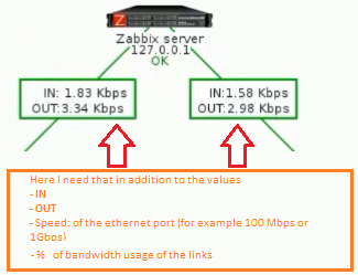

                  Hi guys,
                  A query to both about calculated items, I have an ethernet port of 1Gbps, I have created an item calculated with this formula
                  last ("SW_SALA-CEO: net.if.in [ifHCInOctets.10122]") + last ("SW_SALA-CEO: net.if.out [ifHCOutOctets.10122]") / 1073741824
                  ... and I think it's not right because it gives me this percentage 6576%
                  How can I correct it?
                  I need you to give me the values in percentage from 0 to 100% only.
                  I am at work now, when I get home I tell you about everything that we have talked about here which I am already resolved after a meeting with my superior, it will not be necessary to do everything I asked for and for which I have returned crazy ...

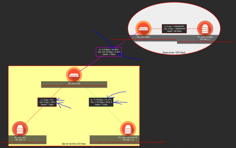

                      Thanks Linwood, my question is because in the map, the links that link each element or host, in the "labels" option I have put the following:
                      - In: {SW_SALA-CEO: net.if.in [ifHCInOctets.10101] .last ()}
                      - Out: {SW_SALA-CEO: net.if.out [ifHCOutOctets.10101] .last ()}
                      - Speed: {SW_SALA-CEO: net.if.speed [ifHighSpeed.10101] .last ()}
                      And now I would need to create a calculated item to also be able to add the result obtained (in %) to the map, as shown in the attached image.

                        I get the desire, I am just saying that a combined percentage is easy to calculate, but has no meaning in the real world.
                        It's like looking at a traffic problem on a road -- if one side is stopped and not moving and full of cars, and the other side nearly empty, your road is 50% busy, but if you are on the bad side it sure doesn't seem like it.
                        Regardless, I think you have the math you need, so you can show it of course. Just think about the question of actionable -- there's an argument to be made that if data is not actionable, you should not be calculating or showing it (actionable does not necessarily mean a trigger, it may be where you go for research for some other trigger). So my non-technical suggestion to you is this: ask how one uses that number? How is it actionable for you?
                        PS. Sometimes the answer is "because my boss wants to see it". I get that.

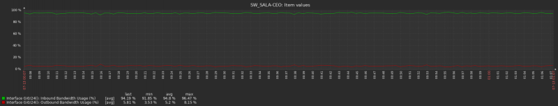

                          Well finally i can create the graph with scale from 0% to 100% of bandwidth usage with two calculated items by separately for example for the interface 24, as you can see on the next pictures
                          Calculated Item for Inbound Badwidth
                          Click image for larger version  Name:	xatjs5.png Views:	1 Size:	14.2 KB ID:	362341
                          Calculated Item for Outbound Badwidth
                          Click image for larger version  Name:	24opovo.png Views:	1 Size:	14.4 KB ID:	362342
                          The Graph
                          Click image for larger version  Name:	28k0n09.png Views:	1 Size:	38.5 KB ID:	362343

                          This is what the map looks like with percentages
                          Click image for larger version  Name:	21o9g1x.png Views:	1 Size:	196.6 KB ID:	362344
                          Thank you so much!!!
