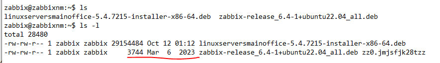

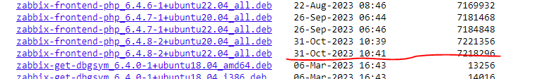

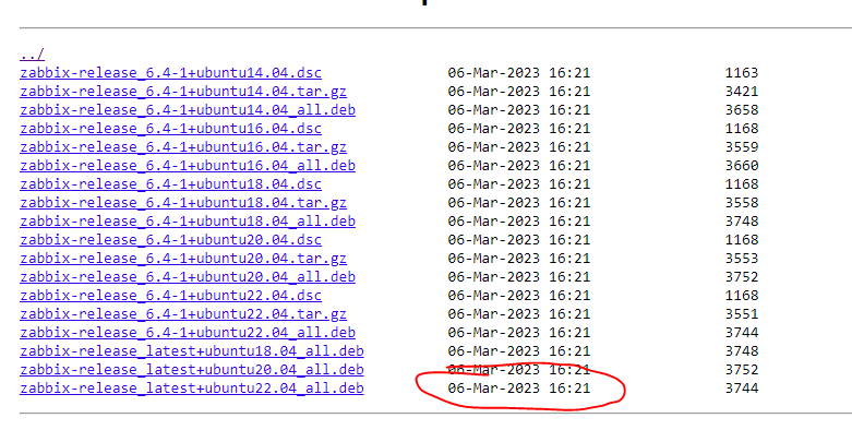

          I really appreciate your feedback. Looking at the web site i found that the releases are all under https://repo.zabbix.com/zabbix/6.4/u...main/z/zabbix/
          Not under the zabbix-release folder.. that is still dated Apr 19-2023 Under the zabbix folder has all the versions of each module, showing 6.4.8.
          If I have to use this folder https://repo.zabbix.com/zabbix/6.4/u...main/z/zabbix/
          Do I need to download each one for Ubuntu22.04 and install them? WHY do they not just have a simple upgrade package?

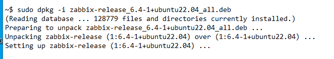

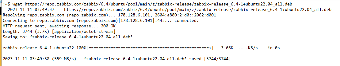

            try
            wget https://repo.zabbix.com/zabbix/6.4/u...u22.04_all.deb
            dpkg -i zabbix-release_6.4-1+ubuntu22.04_all.deb
            apt upgrade
            Wellington

              That is only the 6.4.7 version.Click image for larger version
              Where the actual upgrade 6.4.8 is are all these different installers under this folder Click image for larger version
              there is not a *_all.deb

                unless this is it? Click image for larger version
ID:	473780 the frontend?​

                  Well, I think they got tooooooooooooooooooooooooooooooooooooooooooo excited about the release and FORGOT to add it to the zabbix-release folder for distribution.

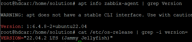

                    You are confused.
                    This is the REPO, valid for all versions 6.4 including the most recent 6.4.8
                    Originally posted by wtdrisco
                    That is only the 6.4.7 version.Click image for larger version  Name:	image.png Views:	5 Size:	62.3 KB ID:	473777
                    These are the packages, which as you saw include the latest version (6.4.8)
                    Where the actual upgrade 6.4.8 is are all these different installers under this folder Click image for larger version  Name:	image.png Views:	6 Size:	135.4 KB ID:	473778
                    Prints from my Ubuntu 22.04
                    Wellington

                      Wellington - So you were able to update to 6.4.8? I am sorry to ask, but can you tell me how you did it? I used the zabbix-release folder and it did not upgrade to 6.4.8 - it stayed at 6.4.7 The reasons I wrote above is the DATE on the files in that folder. Why would they be dated March 2023 when the new release was October 2023. That is why I am confused. I followed the document and it did not update it. So I figured they had not updated that folder. I would GREATLY appreciate knowing what you did to get to 6.4.8

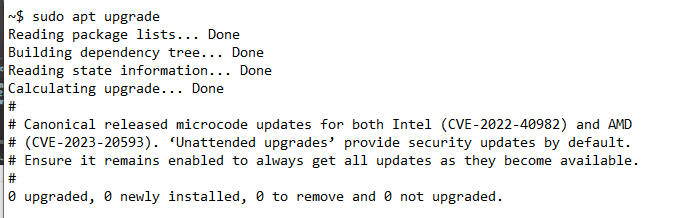

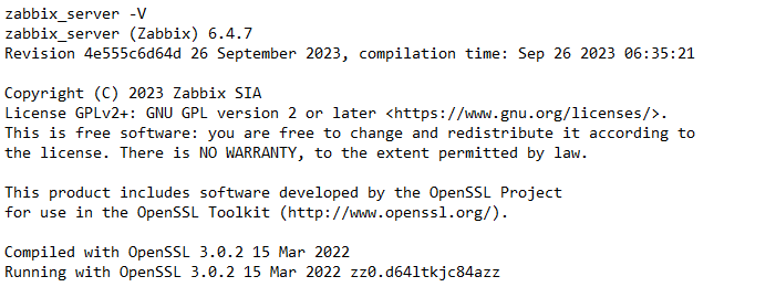

                        As I already had Zabbix 6.4.7 and the REPO, the only command needed is:
                        apt upgrade
                        Confirm which versions are available for your system/repo.
                        apt search zabbix-
                        To see the current version of your zabbix-server, use the command:
                        zabbix_server -V
                        Wellington

                        • wtdrisco
                          • Oct 2023
                          • 24
                          Wellington, I really appreciate your sticking with me.. I tried to wget the file, etc.. and still no luck. The install I did was following the steps on the DOWNLOAD page for this setup.
                          Does that require a different method to update?
                          • wtdrisco
                            • Oct 2023
                            • 24
                            I cleaned up the folder and tried to follow your instructions..
ID:	473843Click image for larger version
