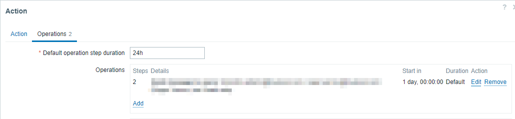

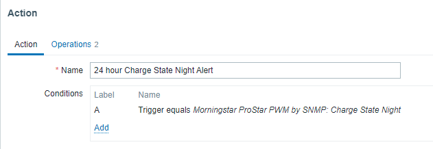

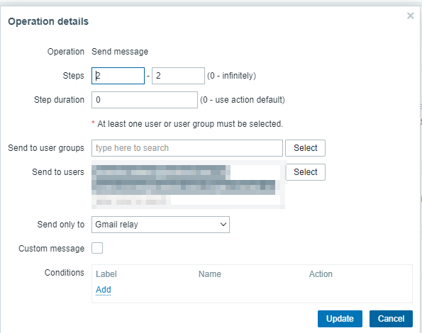

    I have set up a Zabbix trigger to monitor a charge controller, specifically to detect when it transitions from day to night mode. I have an action to alert me if it remains in night mode for 24 hrs. This would mean the solar panels are not properly connected and would warn me accordingly. Every day, they switch to day mode and then at sunset they go to night mode.
    Despite saying the condition has to last 24 hrs, I am getting a daily recovery alert each time it leaves night mode and goes back to day, even though 24 hours hasn't passed yet.

    You can see that I got a recovery notice and the duration was just sunset to sunrise. I want it to wait 24 hrs before it alerts me that there is an issue and that has to be the case before getting a recovery notice. Where do I fix my Action -> Trigger config?
