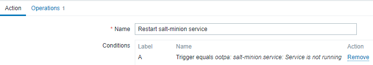

            so it seems like my original trigger action started working after adding the override.conf file as suggested by salavie but the trigger does not work consistently. For example, I have 3 servers in my host group, sometimes it will restart all 3,sometimes only 2 and sometimes not at all and I'm not sure if it's because I have a host under the Conditions statement Trigger equals hostname: salt-minion.service:Service is not running. Below
            Then in the operations, I have the below statement.
