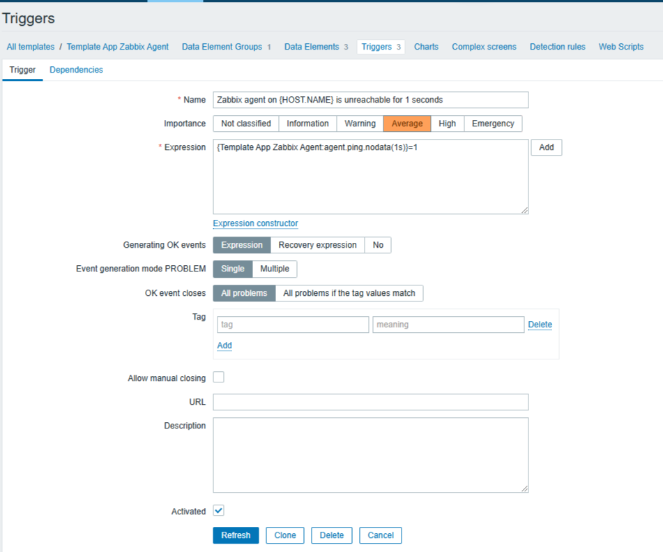

    • orangewq
      orangewq commented
      Already done this, but it doesn't help. I set update interval in 1 second and agent.ping.nodata(1s). Still have delay.

    orangewq but did you also change the problem trigger ?
    • orangewq
      • Dec 2024
      Brambo, yes

          From documentation: nodata(/host/key,sec,<mode>)
          Check for no data received.
          Supported value types: Integer, Float, Character, Text, Log.
          Returns: 1 - if no data received during the defined period of time; 0 - otherwise.
          Parameters:
          • See common parameters;
          • sec - the period should not be less than 30 seconds because the history syncer process calculates this function only every 30 seconds; nodata(/host/key,0) is disallowed.
          • mode - if set to strict (double-quoted), this function will be insensitive to proxy availability (see comments for details).
