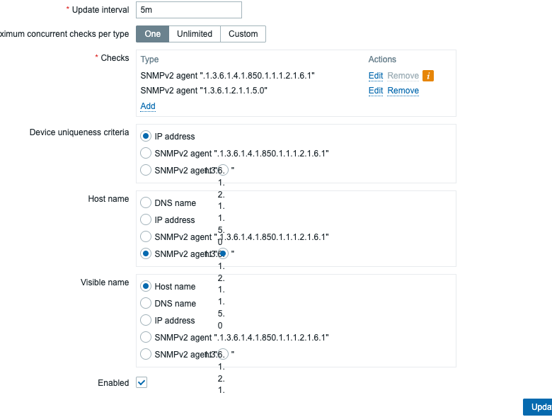

        I figured it out. Chrome does not display one screen correctly. This made it hard to figure out what was listed.

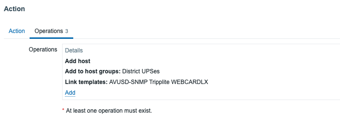

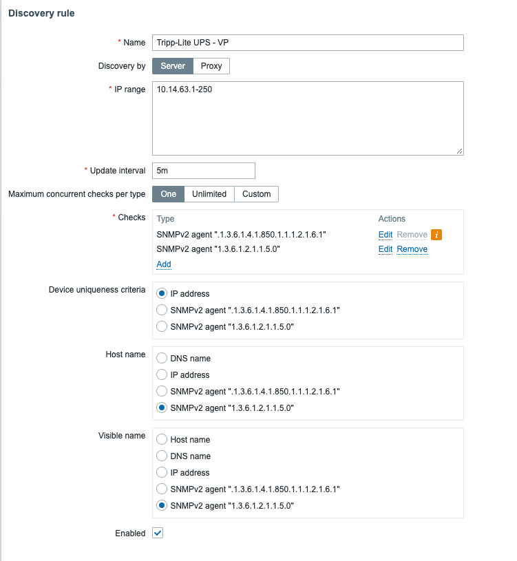

            My latest discovery of UPSes is still placing the IP address in the host name field and the visible name field. I am using the OID that returns the network host name in the discovery rule, and in the Discovery Action screen, I have set Add Host, Add to Groups, and Link Templates as the operations. Here is my Discovery Rule. Is there a setting I should change to get the Host Name text to be the Host name when it is discovered?

                  That is what is shown above. I have the action set to do three things.
Name:	Screenshot 2026-10-02 at 8.18.02 AM.png
                  "Zabbix can use discovered IPs and SNMP information, depending on the device and discovery configuration"
                  Sure, Zabbix can discover things by SNMP, but it isn't automatically using what it discovered where I need it. So, I figured implicitly telling it to use an OID I can confirmed provides the host name should make it work. However, I must still be missing something it the process.

                          We got it working by changing the Visible Name to the Host name bullet and leaving the Host name as the OID. That doesn't make a lot of sense, unless there is a reason the program doesn't like the same OID to be used for two values in the Discovery Rule.

                              #15
                              I tried removing the first OID in the discovery rule I posted above and just left the second one, which is the host name I want shown on the device, and it worked on the 2 other IP ranges. I also set it to 10-minute and 30-minute intervals rather than 5 minutes.
