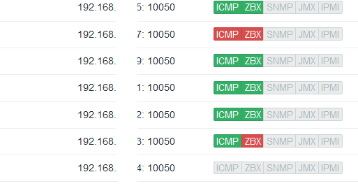

          For my own needs, I made changes in the frontend code that output the ICMP state. If you are interested, I can post patches (but without a good description).

            That's very cool, I'd be interested in the patched (still valid for 5.2?). Do Zabbix take pull requests!?

              Posted with a small description https://www.zabbix.com/forum/zabbix-...tus-of-a-hosts
