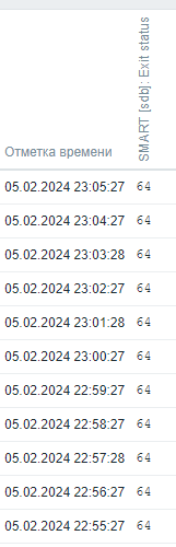

    ​How this trigger should work, I have Exit Status = 64 on several devices, and at the same time the trigger status is OK?
    SMART [{#NAME}]: Error log contains records The device error log contains records of errors. ( count(/SMART by Zabbix agent 2/smart.disk.es[{#NAME}],#2) = 1 and bitand(last(/SMART by Zabbix agent 2/smart.disk.es[{#NAME}]),64) = 64 ) or ( bitand(last(/SMART by Zabbix agent 2/smart.disk.es[{#NAME}]),64) = 64 and bitand(last(/SMART by Zabbix agent 2/smart.disk.es[{#NAME}]),64) > bitand(last(/SMART by Zabbix agent 2/smart.disk.es[{#NAME}],#2),64) )
ID:	478407Click image for larger version
