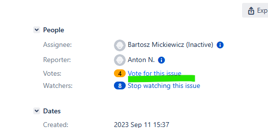

            Please upvote the case created by another forum user to hopefully see the solution someday [ZBX-23394] Azure monitoring for MS SQL doesn't work - ZABBIX SUPPORT
