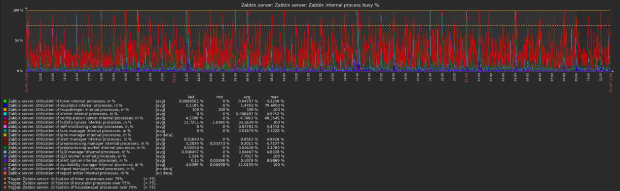

    The problem we have is that some internal process goes to 100%
    The first is Housekeeper, it goes to 100% and keeps running for days.
    History syncer, LLD workes and availability manager also goes to 100%

    I'll share some screenshots
ID:	437654Click image for larger version
Name:	Zabbix Server Performance.png
