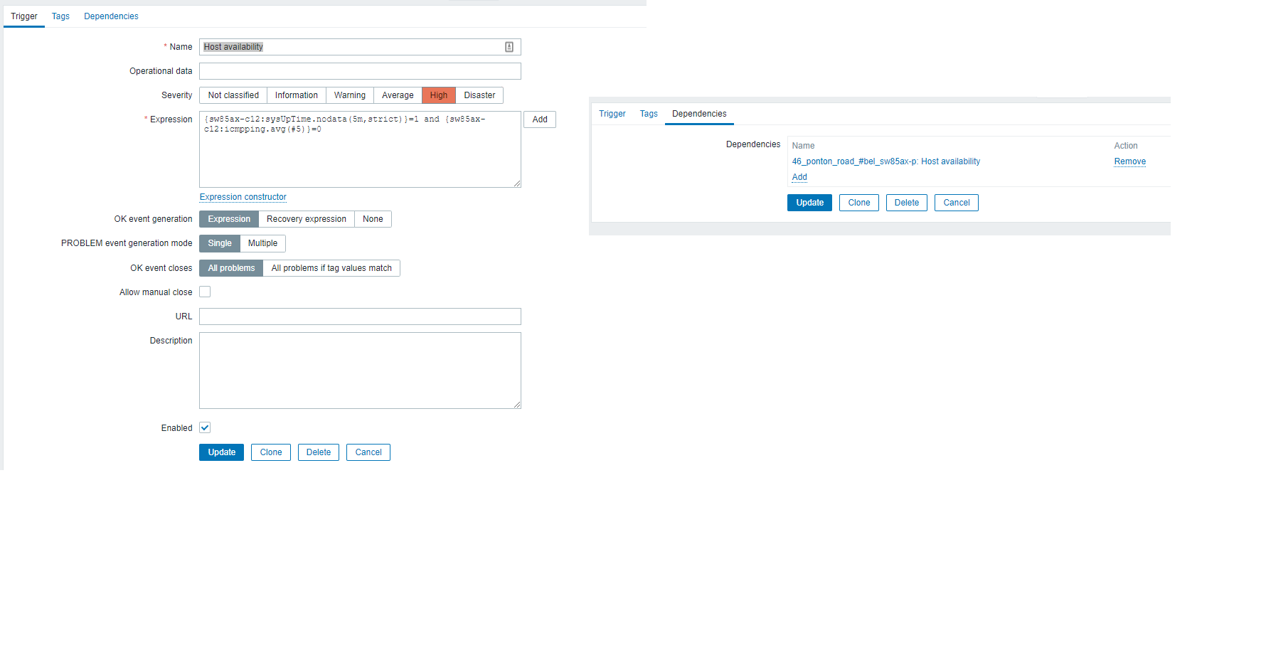

    Can you show us a screenshot how your trigger is configured?

    • Coa
      • May 2022
      • 10
      Hi Markuu,
      There is trigger dependency i forgot to mention but that doesnt have to matter. Trigger on the dependent host is the same config. Topology is, there are two switches that are daisy chained ,call it switch 1 and switch 2. switch 1 is up and running ( all green and ok) . Switch 2 went down , trigger was fired , but once it came back up , trigger got stuck in PROBLEM state.
        Do you mean that you already tested without the dependency and it worked the same?
        Markku
        • Coa
          • May 2022
          • 10
          Yes, trigger stays in PROBLEM state

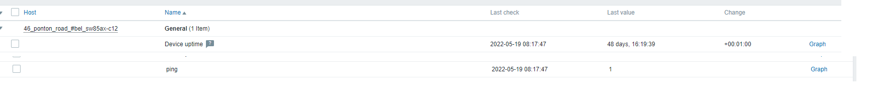

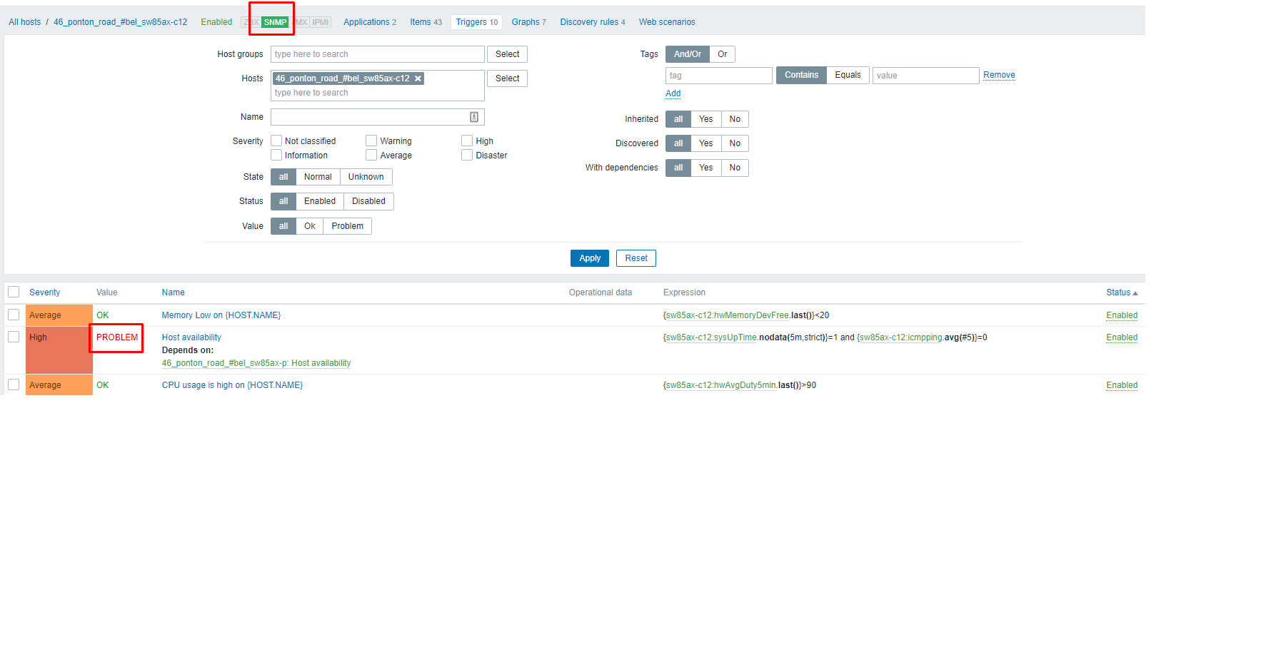

              Here is sc where SNMP is green and trigger stuck in problem state

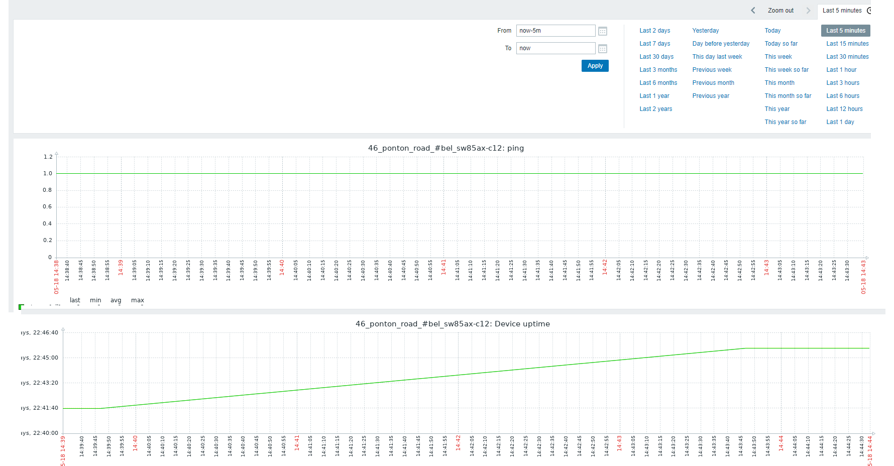

              • Coa
                • May 2022
                • 10
                Here is last 5 min value for host c12 that has trigger stuck

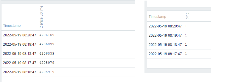

                          Your trigger looks fine. Would you mind still showing the actual values of the items? Not the graphs. Values can be seen in Latest data - Graph (link in the item row), then select Values from the top of the screen.
                          What's your Zabbix version?

                          • May 2022
                          • 10
                          Hi Markuu,
                          Zabbix version is 5.0.16. I waited couple of hours when i removed dependency.
