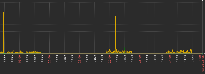

    It has been working randomly these last few days, fine for a few days, then it started producing issues again, then working, ....
    We are currently using latin1 databases, and accents are sometimes replaced by ?
