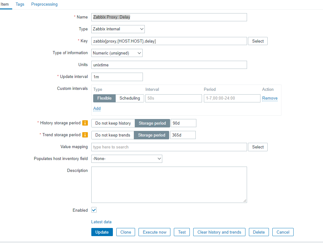

    I've recently created an item and a trigger to create a proxy absence alert. (Config_item.png)
    I created this item on 2 proxy hosts.

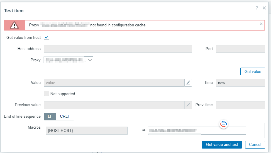

    On one it works, when I test my item, I receive a value that allows me to run my trigger.
    On the other, I see "Not supported" and I get an error: Proxy "HOST-NAME-PROXY" not found in configuration cache. (Error_item.png;Test_item.png)
    I'm on a zabbix server 6.4.1 version, the same version on the zabbix proxy side (it's a dockerized machine).
    Could you give me an idea?

      I know this is an old topic, but I've just recently came across this error on a Zabbix 6.2 instance.
      The item uses the "zabbix[proxy,{HOST.HOST},delay]" key.
      The "{HOST.HOST}" macro refers to the hostname of the host. So, should the hostname be different from the proxy name (configured in the proxy configuration file)
      , the item will become not-supported.
      The "{HOST.HOST}" macro can be changed to the actual proxy name or to another user macro that is set to the proxy name value.
