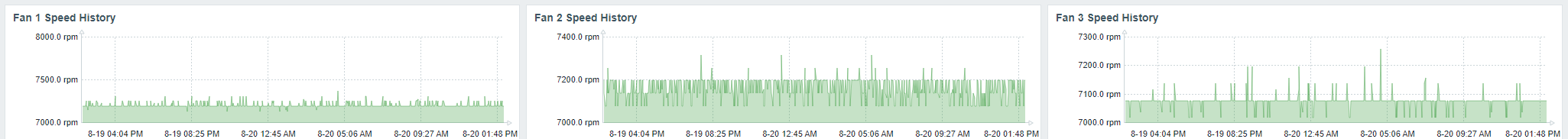

    Zabbix 7 seems to be showing a lot of Gaps in a lot of Graphs, but just not in every graph.
    Shows in all CPU Temperature Graphs
    But not in Fan Speed Graphs
    Could it be due to the template ?, its the default template from Zabbix 7 Dell R840 SNMP

      I'm suspecting it might be the template because below is a graph from the same server with a different template..
