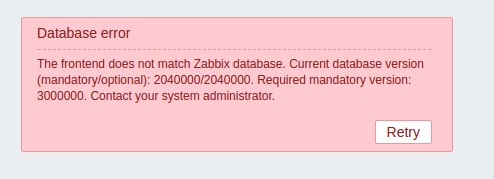

    The frontend does not match Zabbix database
    I am upgradding zabbix-server from 2.4.8 to 3.0 on a Centos 6 (to be more specific on a AMI Linux (aws) ). So i made the backups ,updated the repo and upgraded the packages, but i am getting this error on the frontend and zabbix_server log:
    I understand that the frontend version doesn't match with the database version , but i don't know how to fix this.
    Can anyone help me please ?
    Thank you

    Please try starting Zabbix server.
    When zabbix_server is started, the database upgrade process is automatically executed.

      Hi Atsushi
      I Tried restarting zabbix-server , mysql and apache.... without success the zabbix-server log shows the same error that i posted above.
      Is there a way could i upgrade the database manualy ?
      Thank you
