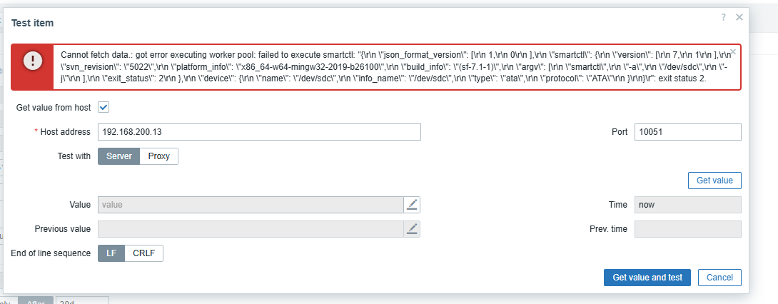

        I have checked all the drives, they working fine. I'm receiving data for each drive
        im not sure if the storage pool is effecting the data if so the smartctl wont be able to read the drives.
        on the other windows server 2025 im getting a different error message

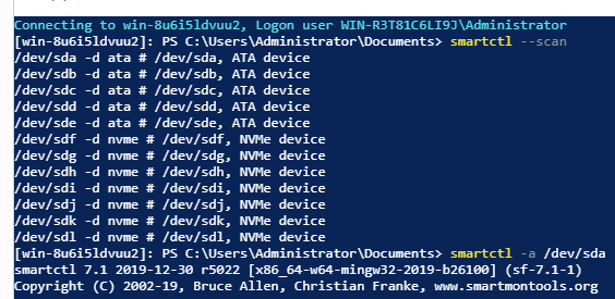

          alright new update ....................
          thanks to this post: Problem with setting up SMART monitoring on windows - ZABBIX Forums
          the smartctl work fine with an older version of Zabbix agent 6.4, however it does not recognize M.2 nor U.2 drivers, only SATA
          this give a clear indication that my settings are correct an the issue is rely on Zabbix agent

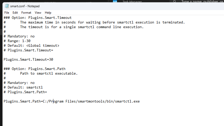

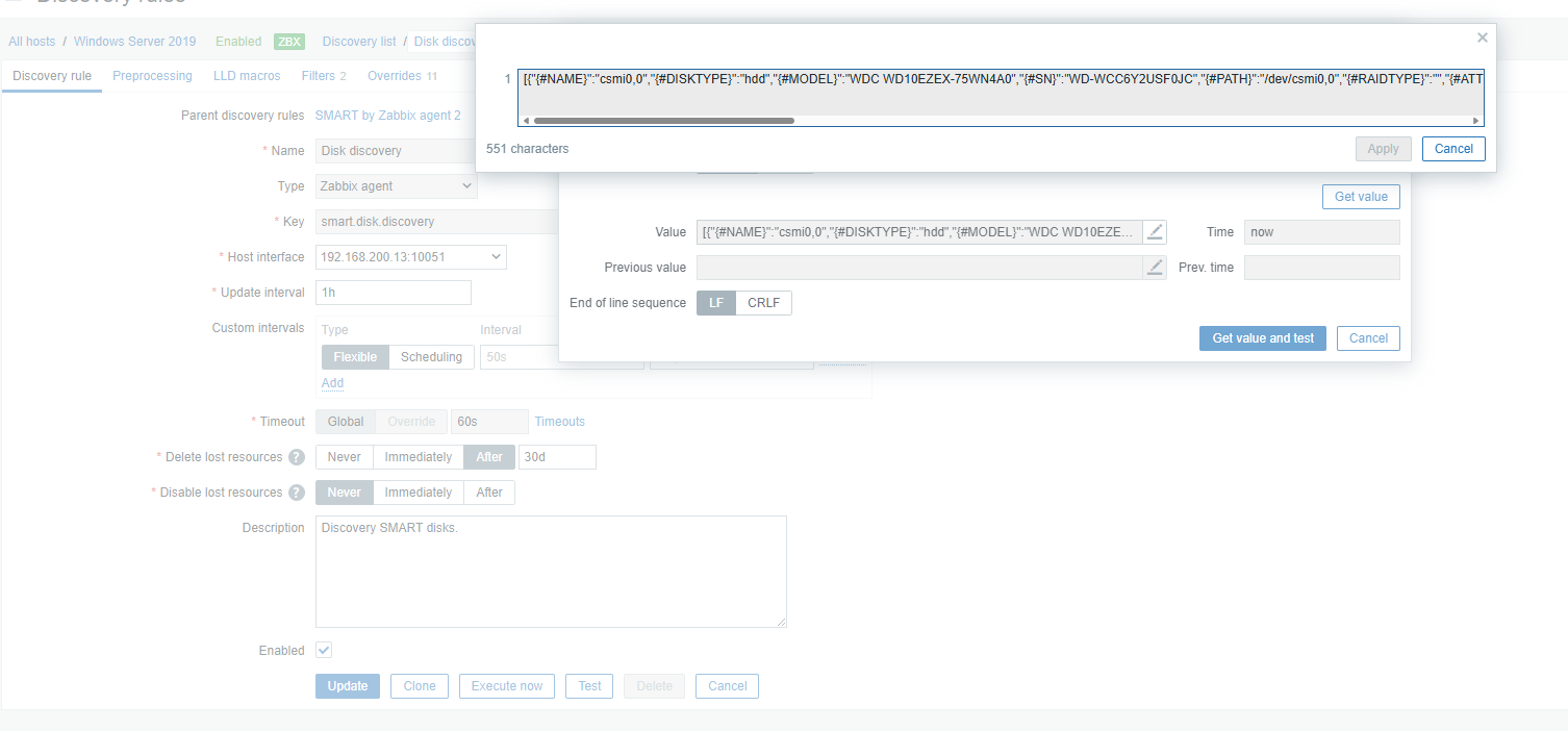

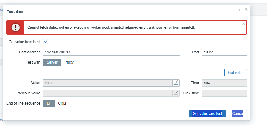

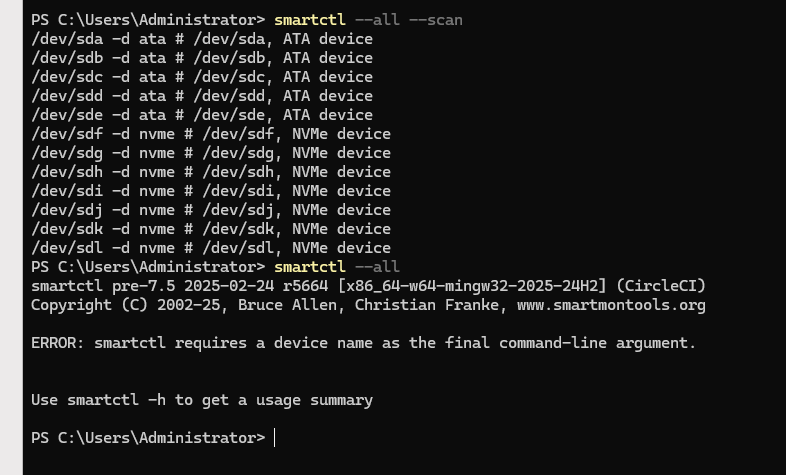

              Update
              i have managed to obtain SMART data in another windows server 2025 utilizing the latest agent version 7.2.4 and smartctl. however the main windows server which having storage pool is not operative, i still recvice error im not sure if this is caused by the storage pool but in the CLI the smartctl function perfectly

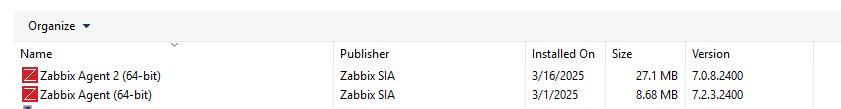

                Can you check agent version 7.0.8 ?
                maybe something was broken in the process of fixing this problem https://support.zabbix.com/browse/ZBXNEXT-9686
                Some changes have been made here related to output processing.
                This is not a security fix. The above was incorrectly mentioned. There is no urgent need to install it.

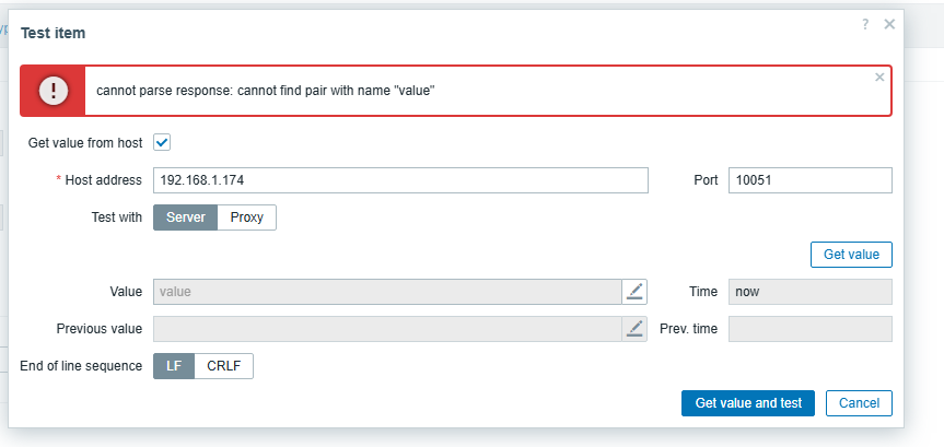

                      thank you. i have downloaded agent 2 - v 7.0.8... it did not work

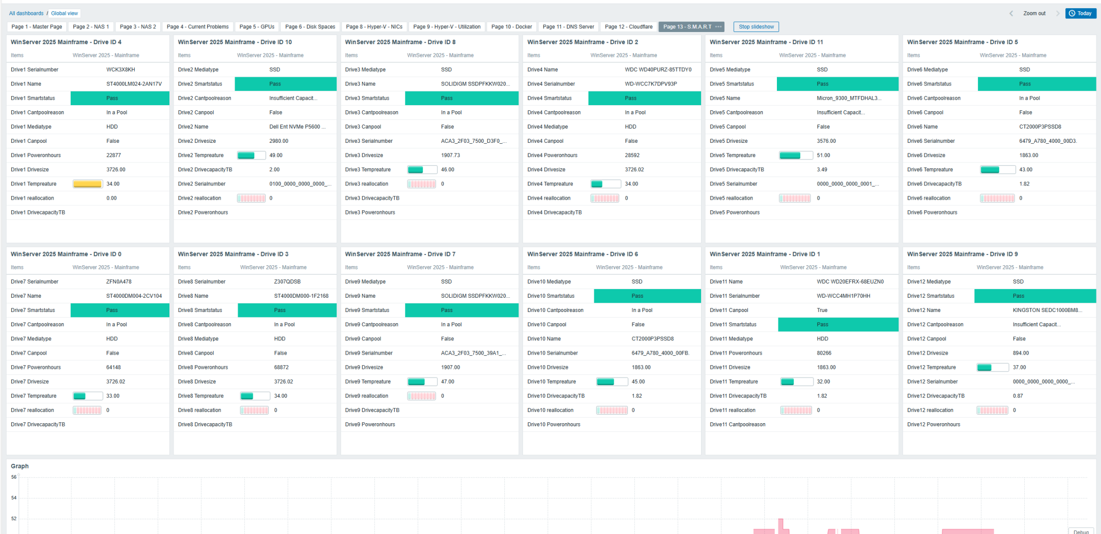

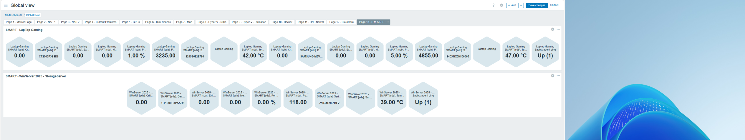

                            After many trials, I have given up on using Smartmontools. However, I've managed to create my own sensors to monitor the mainframe server using PowerShell.
