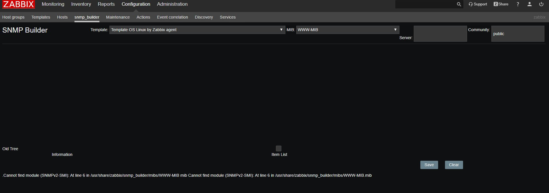

          Hello all,
          on my zabbix server 4.4, it is ko
          "Cannot find module (SNMPv2-SMI): At line 6 in /usr/share/zabbix/snmp_builder/mibs/WWW-MIB mib Cannot find module (SNMPv2-SMI): At line 6 in /usr/share/zabbix/snmp_builder/mibs/WWW-MIB.mib"
          Any idea ?
          Tks in advance.
