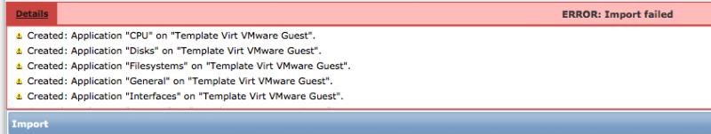

                          • Bittone
                            • Apr 2014
                            Import fails
                            Hello Guys,
                            juts performed an update from sources (2.0.6 -> 2.2.3) and everything worked just fine, no error in the logs and old data is still there.
                            I'm now trying to import the new templates for VMware monitoring but import fails withe the attached errors.
                            Can you please help me ?
                            Bittone
                            • richlv
                              Zabbix Certified Trainer
                              • Oct 2005
                              • 3112
                              #15
                              the error is not visible (and it might be a better idea to copypaste it)
                              just a guess - did you observe the sequence in which to import the templates, as per the note on the template page ?
