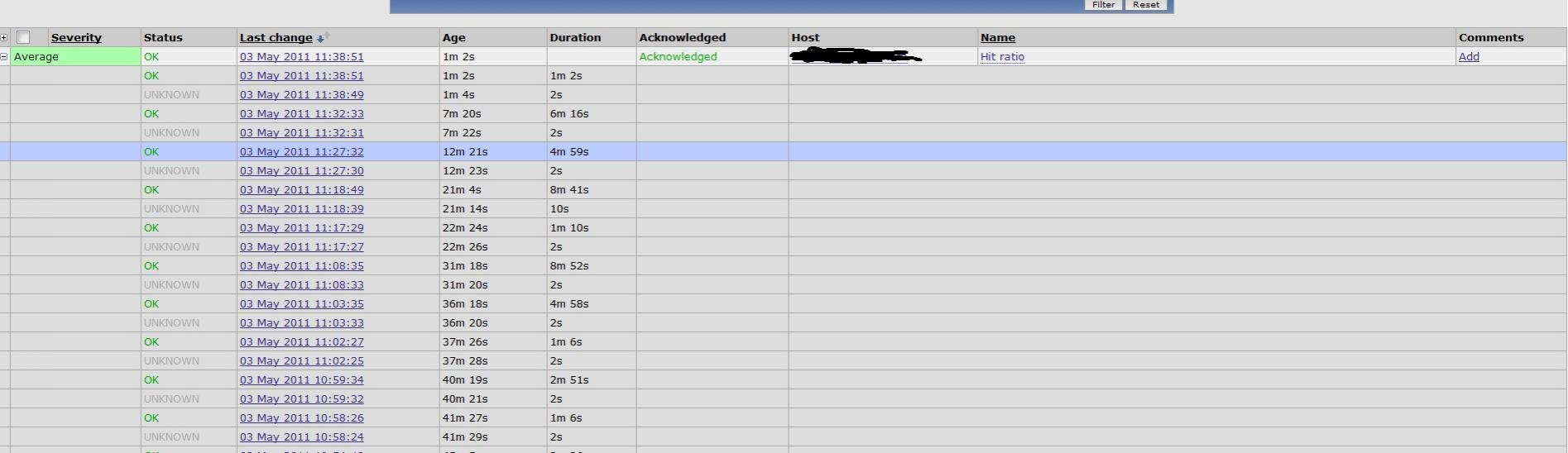

      Originally posted by dalle
      This is really strange, because on my template all item are Zabbix trapper and they should not have a "Unkown" status.
      Dalle thanks for your quick reply and support!
      My items are also all trappers.
      I have attached an screenshot of the trigger history.
      Also in the server log I see this and I think this has to do with the trigger:
      Expression [{17038}<50|{17039}<50|{17040}<50|{17041}<50] cannot be evaluated: Evaluation failed for function: avg
      • dalle
        Zabbix Certified Specialist
        • Mar 2009
        • 402
        #258
        On my environment doesen't happen, Orabbix is running on Oracle 10g all the items have their own values?

        • eppie
          • Jun 2009
          • 15
          #259
          Mine also have also values. What could be the reason that the function avg fails?
